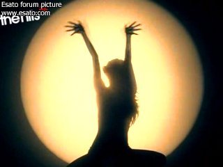

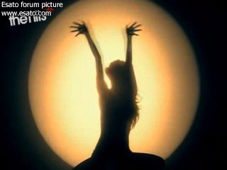

dcuk
Joined: Jun 28, 2005
Posts: 121
Posted: 2006-08-23 17:24
Hi mysh,
Thank you for your reply.
Another quick one about aspects, I mentioned before that I use 1.25 when I manually crop and you're using 1.33, the real conversion PAR should be 1.22 when converting from 720x576 as 8 lines either side of the frame are not usually used so it's actually 704x576 or 704/576=1.2222 which produces the nearest circle you can get, 320x240 has a DAR of 4:3 PAR 1.3333 but in encoding we should use the source file for PAR calculation instead of the destination PAR
1.33
1.22
Screen grabs from 'Pussycat dolls - Buttons video'
cropped and resized 320x240
(I forgot till now, I used to use 1.25 on the k750i as the way I used to encode videos to get full 25fps smooth as silk was a lower resolution that was stretched to fill the screen so needed 1.25 to fix the proportions at the time)
Hope this helps in some small way with your program!
Cheers,
Dcuk
[ This Message was edited by: dcuk on 2006-08-23 16:43 ]
