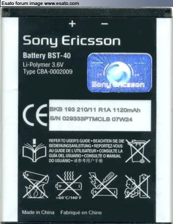

Devildriver
W910 Black
Joined: Oct 16, 2007
Posts: 29
From: Germany
Posted: 2008-03-11 01:18
My mistake, the Picture I took from Guenstiger.de is wrong, looked at "SE eShop" and it looks like this
BST-40
Rookwise
Joined: Mar 22, 2004
Posted: 2008-03-11 01:24
@devildriver
Thanks for that pic. Clears a few things up. Just compaired the pic to my W960's BST-33 and the +/- terminals are in the exact same place and the recess's in the top corners are the same.
W960's BST-33 battery is 950mAh
P1's BST-40 battery is 1120mAh
Might just pay the Ģ40 and get one to try as I don't have my P1 anymore. Only K800's and 2 W960's.
